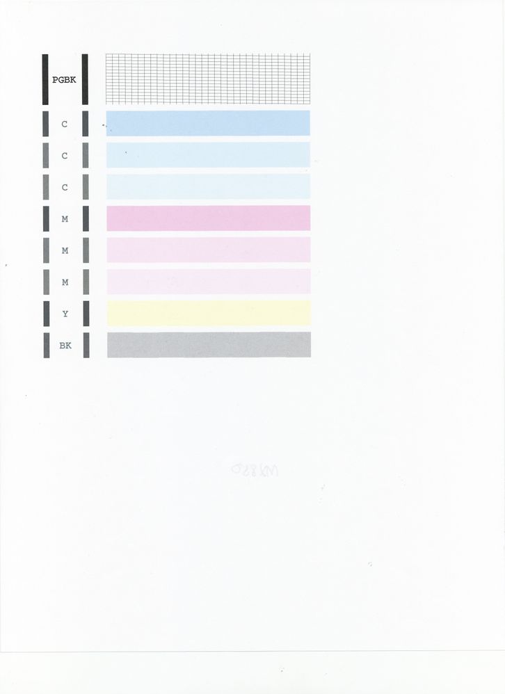

Did a black grid print to the right of |PGBK| at the top of the page?
Are there any boxes missing within the grid?
Below that, did 3 blue, 3 pink, 1 yellow and 1 gray bars print?
Does your printout match the example below?
