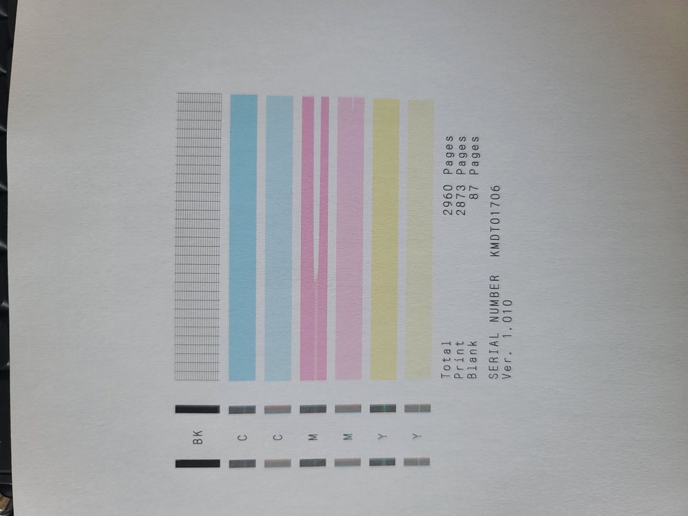

12-01-2024 01:02 PM
12-09-2024 05:15 PM
Hi thaley46201,
Thank you for the image, it shows that the magenta is not printing correctly.
The next step would be to perform printhead cleanings.
