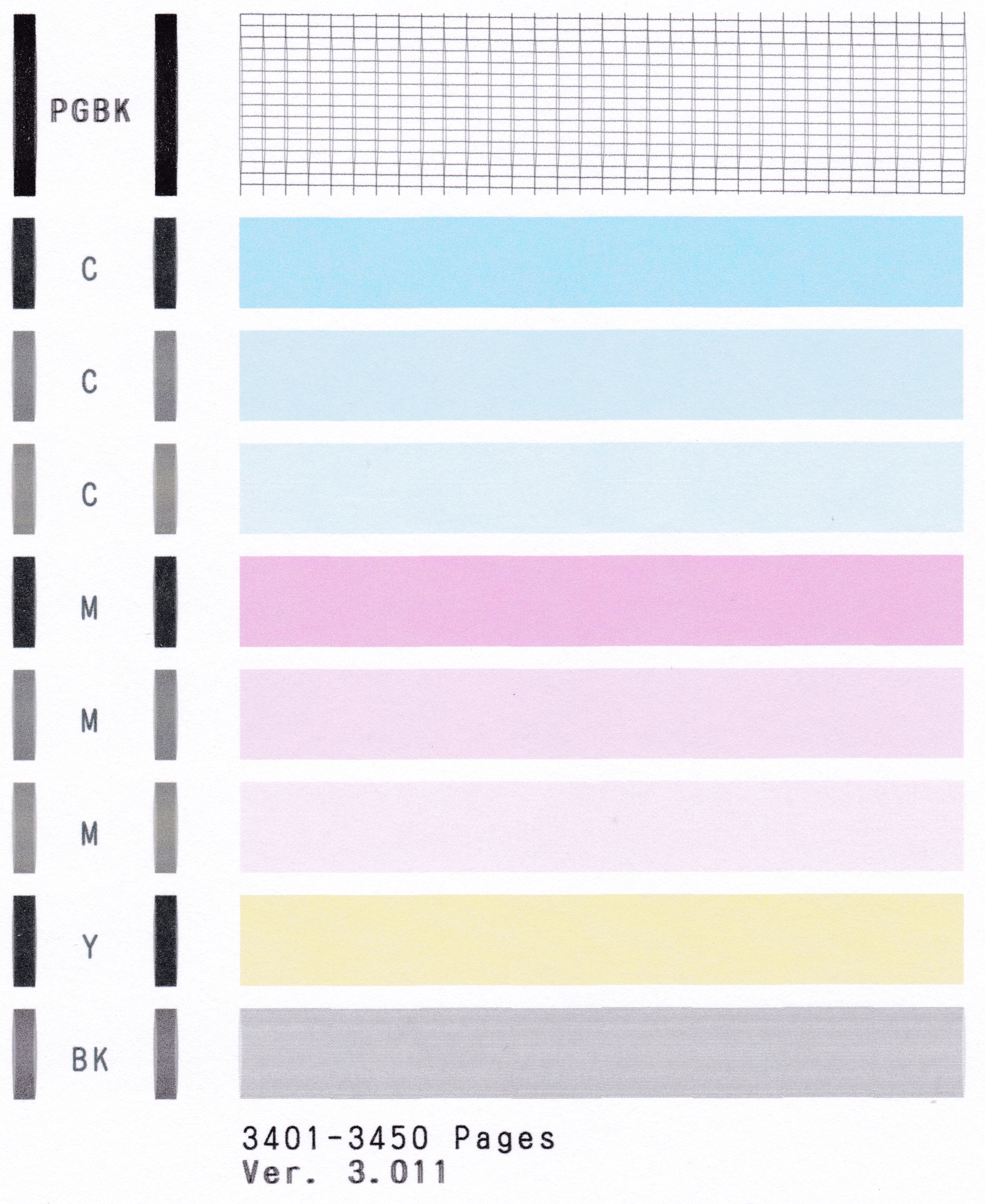

I've also printed the current nozzle test pattern, which looks like this:
MX922 Nozzle Test Pattern
Note especially the PGBK pattern - it is sharp at the top and bottom, but progressively offset towards the middle of the pattern.

Thank you for the suggestion. I've just re-cleaned the encoder strip (both sides) as well as I can - it's really difficult to reach into the printer far enough to get the entire thing, but I managed.
New nozzle print check shows exactly the same pattern in the PGBK. No change at all.

Thanks for the suggestion to re-seat the print head. I not only did that, but also cleaned the print head with isopropyl alcohol. Nothing made any difference at all. I suspect it needs a new print head. In looking at options for purchasing a new print head, I discovered that Staples (an office suppy store near me) had this exact printer on sale for $69 US. This was at least $30 cheaper than I could find a replacement print head for, and I would not have to wait for a print head to ship to me. So I just bought another one, which I'll use until I run out of all the inks I have stocked up. Once that happens, I'm switching to a printer with larger ink tanks - probably from Epson.
