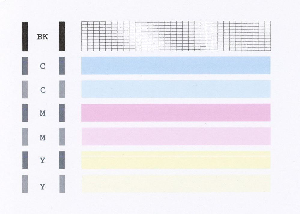

Just to verify, please print another nozzle check.  Once printed, please compare your printout to the example below.
Does your nozzle check match the example below?
The nozzle check does not print that pattern. It only prints the "BK" portion. The color cartridge is empty and I've never replaced it given i do not have a need for color other than black.  Could the empty color cartridge prevent it from copying?  Even, though i press the 'Start/Black' button?
Hi mlafarlett,
When using the automatic document feeder to make copies, the PIXMA MX340 prints from the color cartridge, combining all of the inks to make black.  To resolve this, please replace the color ink cartridge.
