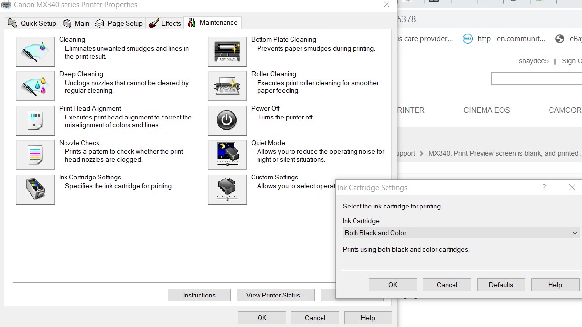

Maybe a stupid reply if you've already done this, but did you try the setting to only use the Black ink? I think this might allow the printer to ignore the Color cartdrige. Hopefully the Black will begin printing again.

11-05-2021 09:43 AM - edited 11-05-2021 09:45 AM
Thanks for your kind response.
@shaydee5 wrote:...did you try the setting to only use the Black ink? I think this might allow the printer to ignore the Color cartdrige. Hopefully the Black will begin printing again.
I wasn't aware of that option.
I found it and set to Black. So, far that hasn't solved the issue..

I've decided to do all the checks shown in your screenshot.
So far, I've done "Bottom Plate Cleaning". That showed no smudges from the internal components.
I did "Nozzle Check". That was perfect - relative to the example screenshot that Canon give.
