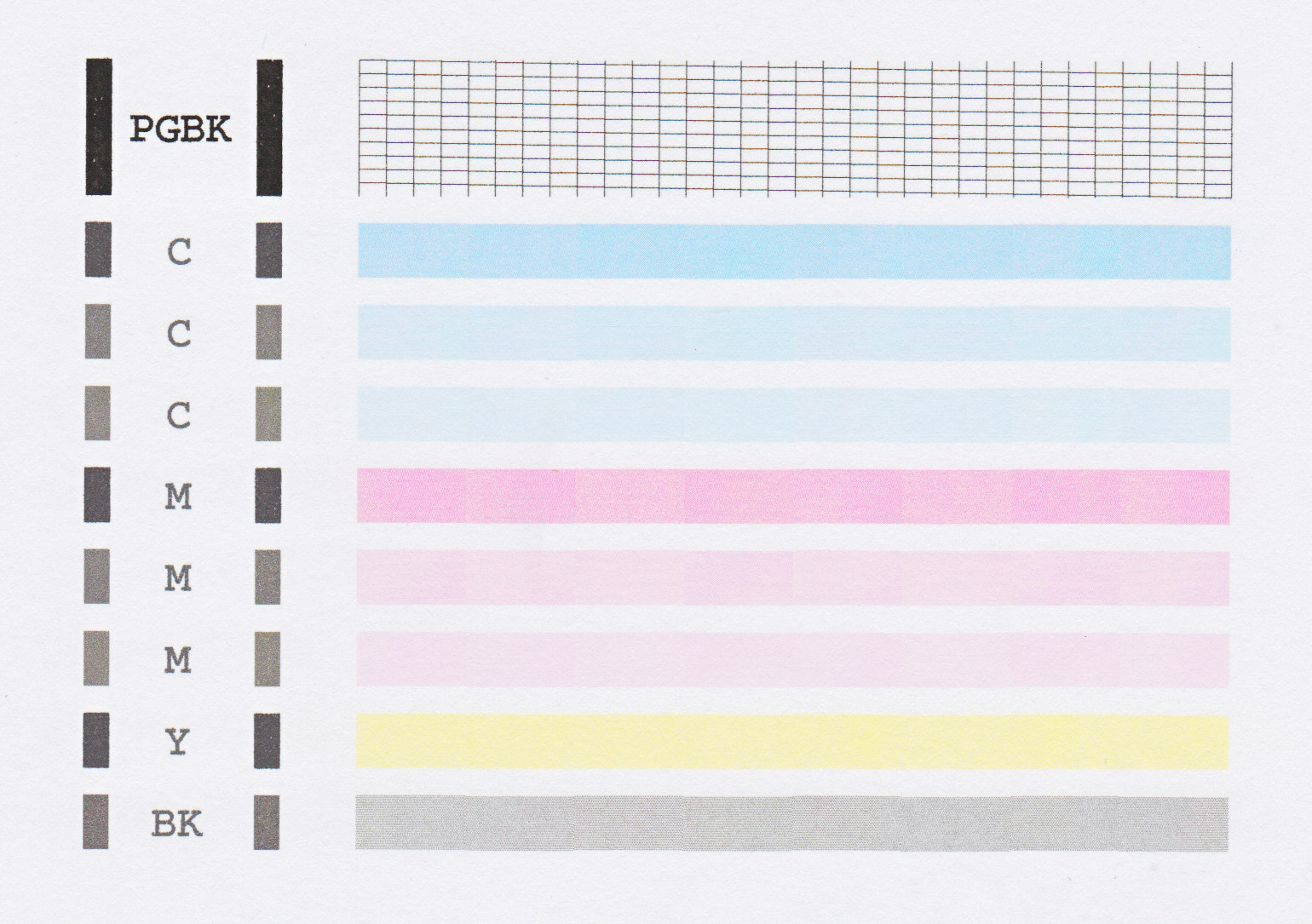

Next, a test of the printer should be performed. This will tell us if the printer is working correctly. To do this, please load letter-sized paper in the PIXMA MP620 and follow these steps:
1. Press <HOME>.
2. Rotate the menu to Settings and press <OK>.
3. Press <OK> on Maintenance.
4. Press <OK> on Nozzle Check Pattern.
5. Press <OK> on Yes.
The Nozzle Check will print. Please compare your printout to the example that has been attached to the bottom of this post. If they differ, please perform a few printhead cleanings.
To perform cleanings, please follow these steps:
1. Press <HOME>.
4. Press <OK> on Cleaning.
After a few cleanings, please print another Nozzle Check.
Does the Nozzle Check print correctly?
1. Press <HOME>.
