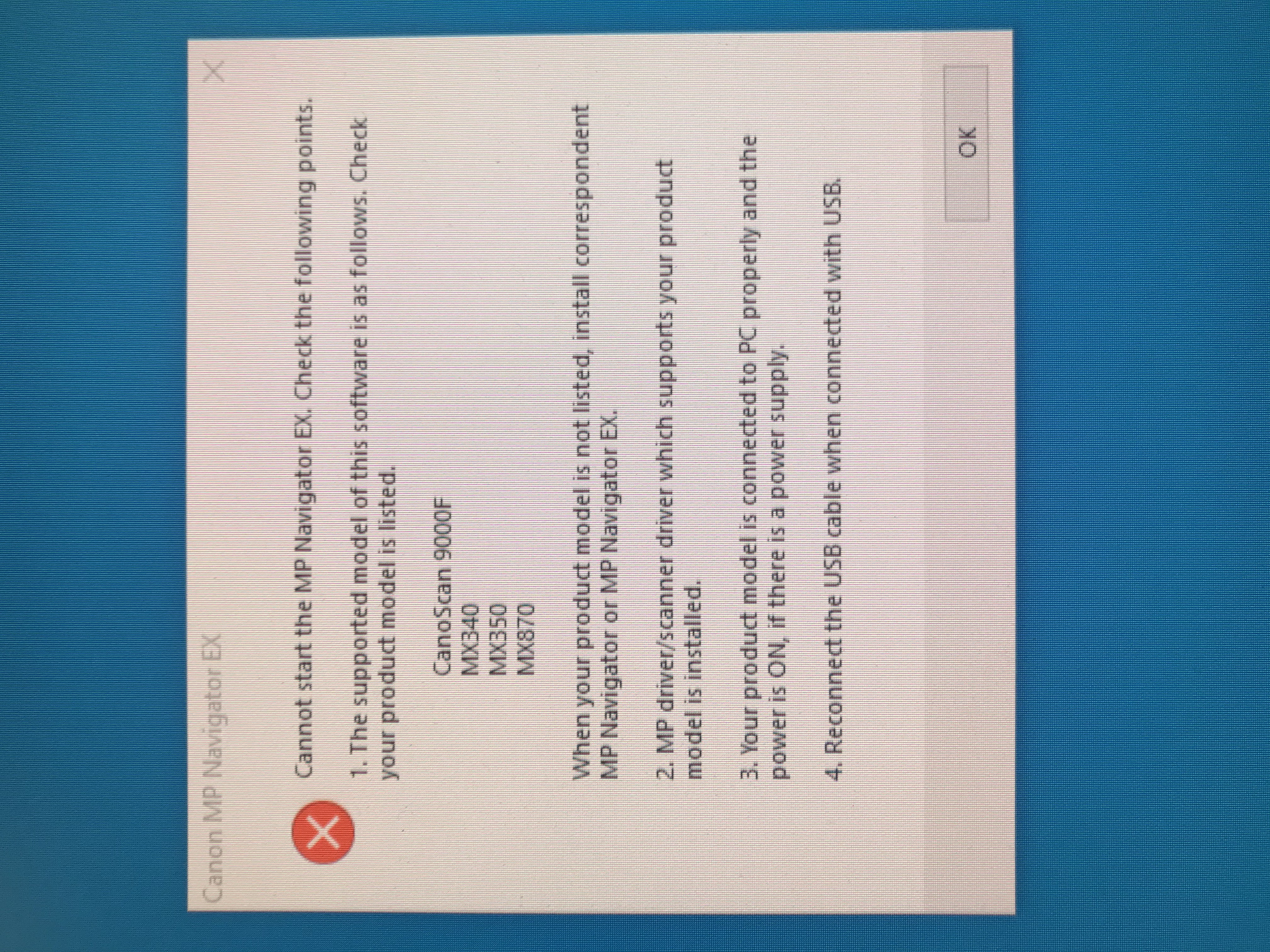

I tried scanning something yesterday and got this error message (I don't know why the image of the message displays sideways on my PC). I last scanned something 12/09/2019. Since then, Windows installed two updates on 12/10—KB4530684 and KB4533002. I uninstalled both those updates and uninstalled MP Navigator 3.15 and reinstalled Navigator and the problem and error message continued. I reinstalled the updates and then reinstalled Navigator and the problem continued.
Also, when I connect the printer to my PC via USB and try to scan using the buttons on the printer, I get a message that the scanner driver has not been properly installed.
As I said, it worked on 12/09/2019 when I last scanned something. Canon support wants $19.99 to help me with this, but all I want to do (besides get it fixed) is tell Canon that the latest Windows 10 Updates is messing up Navigator so they can fix the driver or contact Microsoft, but their customer support voice menu doesn't allow that option.
I have done all the uninstalling and installing I can think of, and nothing makes my scanner work.
Pixma MX870 printer, MP Navigator EX 3.15 07/22/2015 (the latest version for the MX870). Any help?

Thanks for the step-by-step instructions. Unfortunately, it didn't solve the problem. I even uninstalled Navigator and reinstalled it, and I still get the same error message on my screen shown in the photo I posted.
Initially I couldn't even remove the driver only per your step 10. So I removed EVERY Canon MX program and printer, then rebooted, then installed the MP Driver 1.06 and MP Navigator and tried it. Got the same error message. So I redid your steps, and this time I was able to go through step 10. and onward from there. I did steps 1–20 and then reinstalled both the MP Driver 1.06 and the MP Navigator driver. But as noted above, even after uninstalling and reinstalling MP Navigator, the problem remains.
I still think it's an incompatibility issue between the two 12/10/2019 Windows updates and MP Navigator 3.15 (07/22/2015). Hopefully Canon and Microsoft can resolve this.
