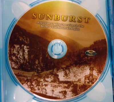

Here's a disc with simple black text. The text is very, very light, but should be dark black.
And here is a full-color print. The black ink just stops halfway down the disc. And the colors on the top half are not correct.
The colors on the disc above should be similar to the colors on the paper insert below, which was printed on the same printer, just before I printed the disc image.
