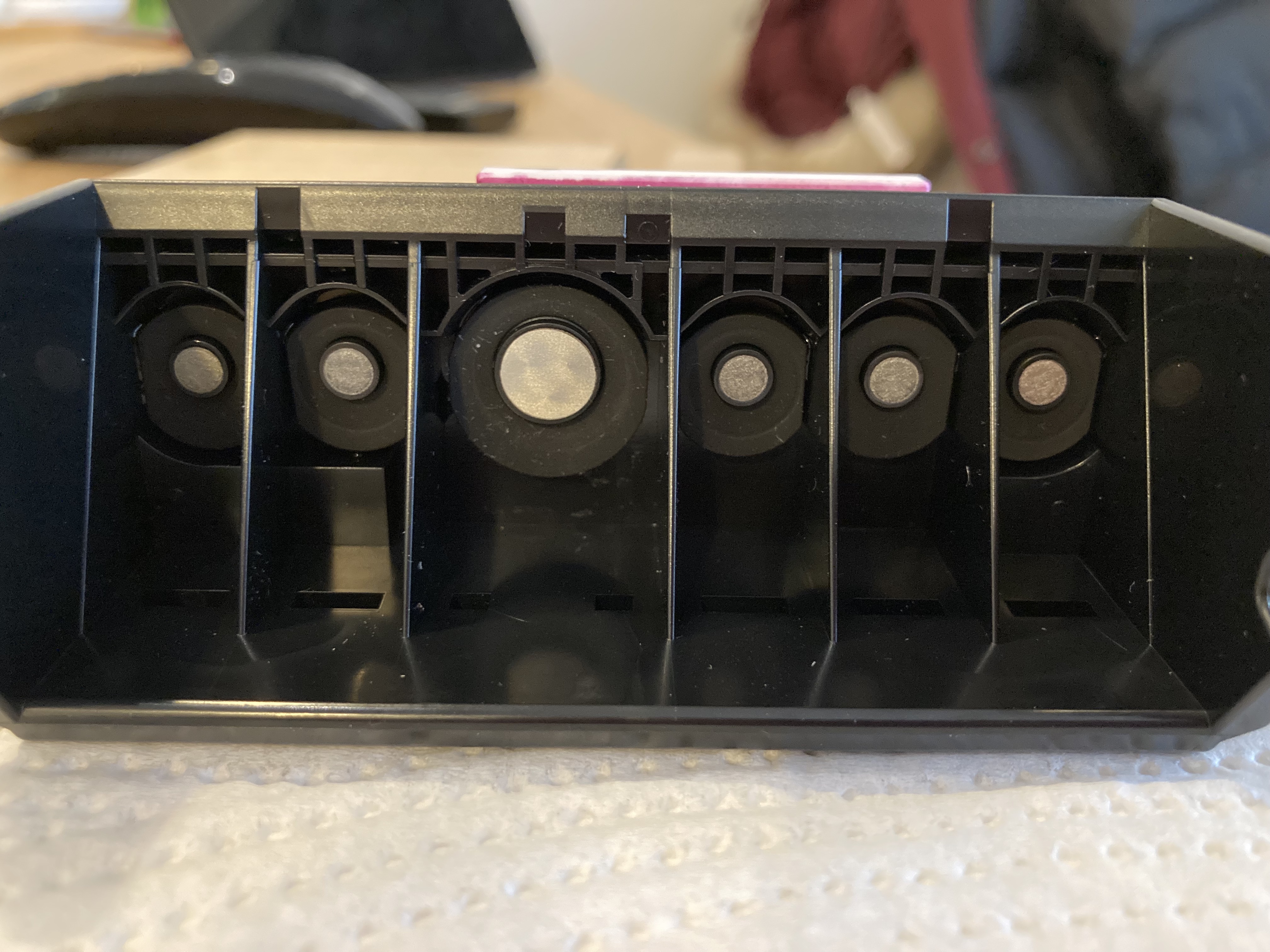

I think that I have had this problem for years. My MG6250 was in the storage for couple of years, but now I took it back in the use, and I have the problem with printing the black ink. While cleaning the printhead, I noticed something. For the other colors, the printhead surface seems to be a bit rough, but for this problematic black color, the printhead surface is completely smooth. Also, when I touch the printhead with a piece of paper, all the other colors leave a color mark to the paper, but the black one, the smooth one, doesn't leave any mark to the paper. Is this normal? Is my printhead missing some piece? I'll also attach a photo here, maybe to explain better the problem.
Maybe it can also be seen in the photo, that the biggest printhead, which is the not working black one, seems to be more shiny than the other ones.
What can I do? Is this normal? Do I need to buy a new printhead, would that solve the problem?
Thanks a lot for all the answers already beforehand!

For information to anyone with the same problem: eventually I ordered a new printhead from Ebay, I think it was shipped from PRC to me in Finland, so it took some time to get it, but the cost was not huge: it cost a bit less than 40 USD, including shipping and sales tax. When I got the printhead, it was easy for me to replace the old printhead with the new one. I did this already some time ago, so I don't remember exactly how it went, but iirc, when I installed the new printhead, the printer did something for couple of minutes, before it was ready to be used. And, after that, luckily my problem was solved, so the new printhead indeed seems to have fixed my problem! So, now the big black ink cartridge is working again.
So, like I already wrote, if you have similar problem as I had, it's possible to fix by yourself, when you just buy a new printhead.
