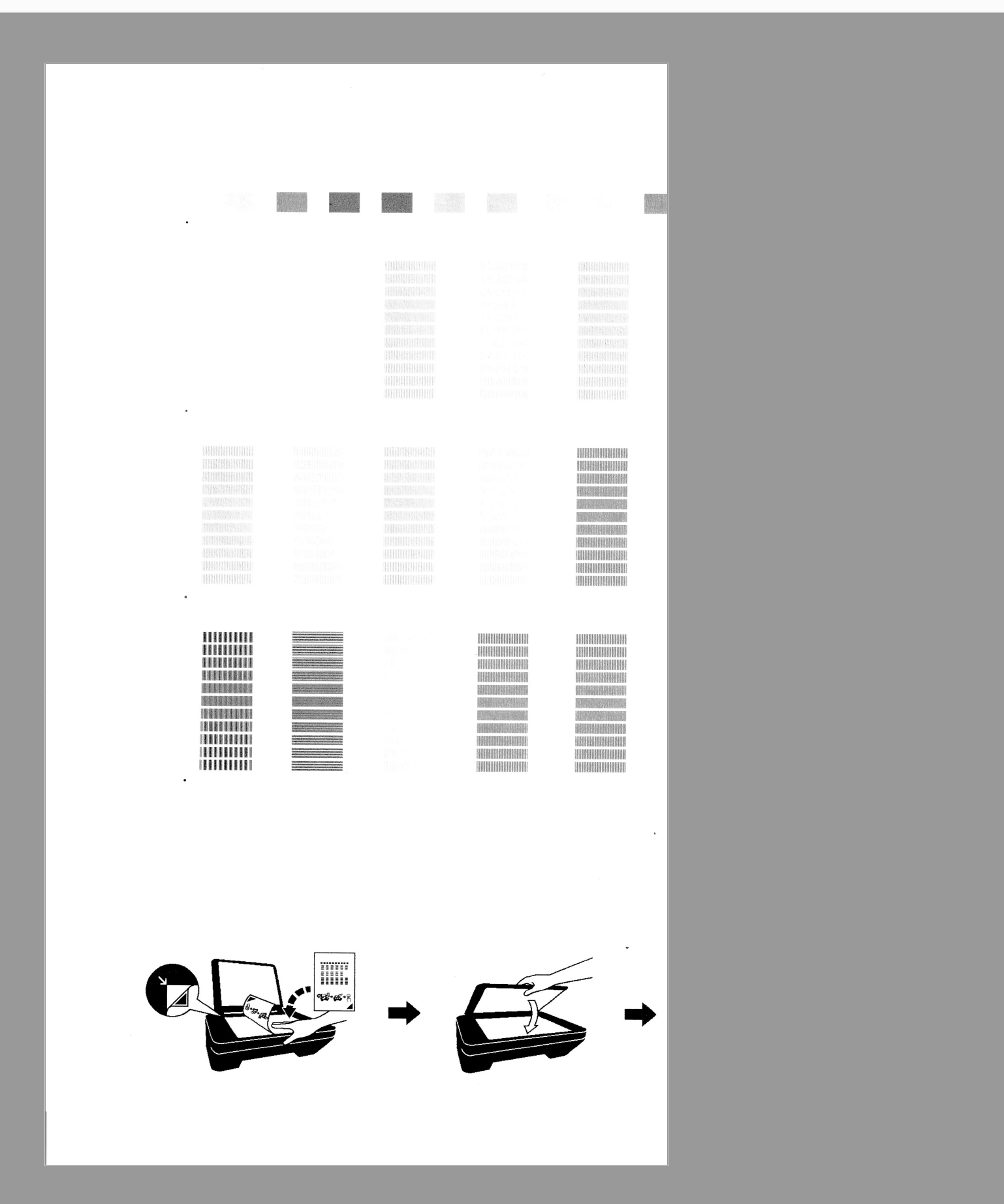

My MG3010 has been scanning fine up until a couple of days ago. The problem was intermittent at first but has now become steady. When scanning, either with the IJ Scan Utility 2 OR with Scan Utility Lite, the resulting scan only shows the left 2/3's (or so) of the page. Scanned image inserted. I assume you know what the full image is supposed to be as this is the print test from the MG3010. All images, not just this one, have the same results. Thanks for looking into this.

Both scanning with the driver and copying result in the full image. Tried scanning document image with Utility again and got the previous results... partial image.
