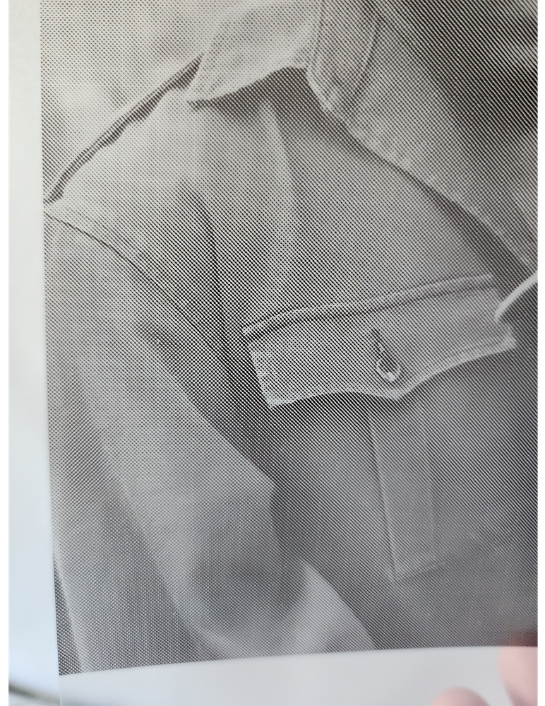

I recently have been encountering an issue with my IX6820 that has me beating my head against the wall and I cannot seem to fix it. Whenever I am printing half tone transparencies for screenprinting I encounter these cross-lines when the dot degree is at 45. At 22.5 degrees it is greatly reduced but still barely visible.
I've ran a cleaning and a deep cleaning and have done at least 3 nozzle checks with no apparent lines or streaking. Any ideas?

I had to really study the picture to see the cross-hatch pattern of lines. This takes me back to my graphic arts photography days.
How are you producing the screened image that you are printing on your printer? Did you scan an existing halftone?
I think what you are seeing is a moire pattern, also called an interference pattern. It occurs when similar regular line or dot patterns are superimposed. If the patterns are at the same angle it can be very pronounced, and reduced by rotating one of the patterns.
Your image has one pattern, and the printer's rows of dots (pixels) is another pattern. These patterns are at 45 degree angles, which is the angle that is least obvious to human vision. You are minimizing the effect by rotating one pattern to 22.5 degrees. But it can't be eliminated entirely.
This is from Wikipedia's article on Moire Patterns. Check it out yourself. "Some image scanner computer programs provide an optional filter, called a "descreen" filter, to remove moiré pattern artifacts which would otherwise be produced when scanning printed halftone images to produce digital images."
Possibly changing the dpi setting on your scanner or rotating the original halftone in the scanner would make a desirable change.
What will you be screenprinting on? Perhaps the pattern you're getting will lessen the visual effect. Like fabric maybe.

This image was edited and printed directly from Photoshop at 600ppi with no scanning. I did learn about moire patterns through troubleshooting the issue but I assumed the resolution of the printer being 600x600dpi for black would negate that effect. This is a transparency I will be using for screen printing t shirts. I was also thinking it might not be too noticeable once printed if I set the degree to 22.5 instead of 45. It's frustrating cause it seems the actual artwork is being "changed" during the printing process since these lines are not apparent when zoomed in on Photoshop and like I said, I don't think I'm over-pushing the resolution of the printer. The only other thing I can think of to try is to readjust the halftone bitmap back to 300ppi when converting to see if a lower resolution fixes the issue. I guess we shall see. Appreciate you trying to help, normadel!

Consider the application. Even as the pattern appears in the photo, I'd bet that on a T-shirt it won't even be visible. It's not extreme now, and on a shirt fabric that is not holding still to be studied finely like I did will lessen the problem.
Anything you do to make the patterns more dissimilar....angle, screen ruling, etc.......should help.
