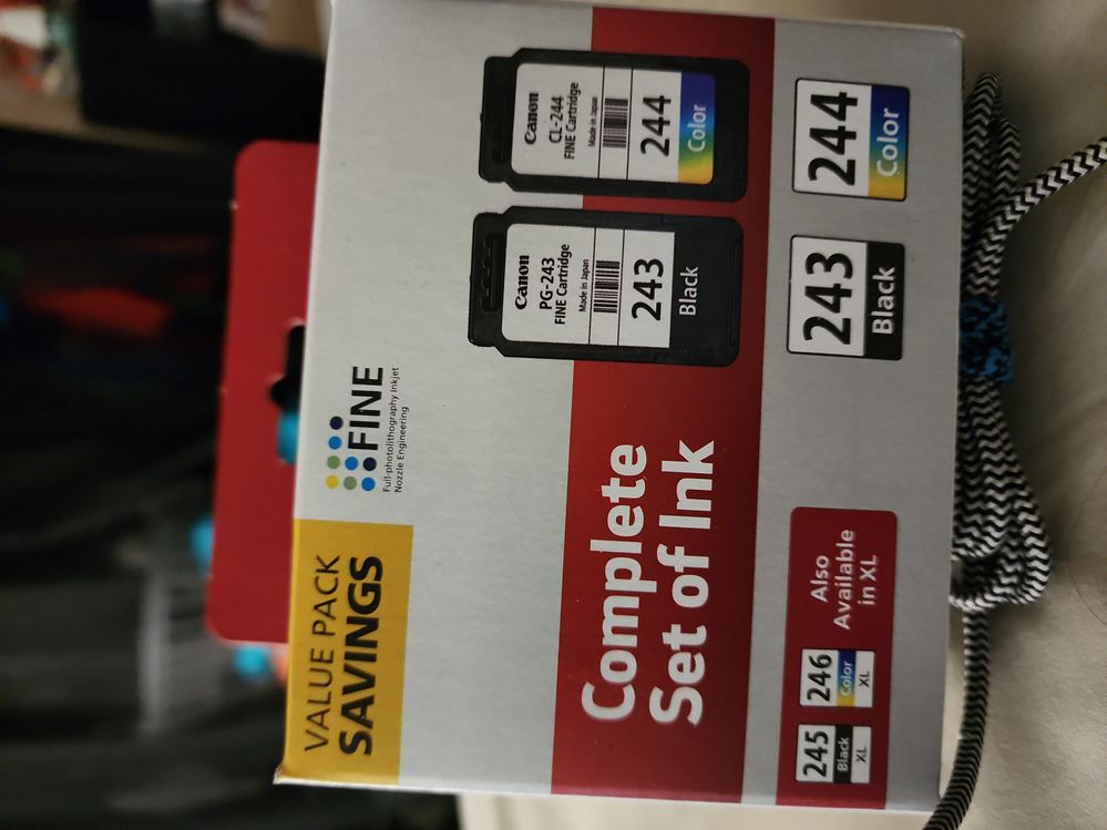

I am having almost identical issues!!! I have tried removing the cartridges, turning off the printer then reloading. Finally I just bought an entire new set of black and color. Then removed the app, reinstalled it and tried to start over with no luck. I am using the cartridges that were recommended by the manufacturer - Canon PG243 (black ink), Canon CL244 (color ink). Keeps showing the blinking lights and error message!!! The "instruction manual" that comes with the printer DOESN'T HELP AT ALL! Tried using youtube with no luck. Any other ideas?This is what I use
