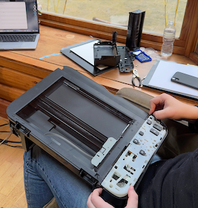

Hi, I have not one, but TWO Pixma MG3620s of an *ahem* vintage age, but they suddenly BOTH stopped working. One is flashing amber three times and one is flashing amber two times. Both are "printer jam" type errors.
I have disassembled one, and cleaned the rollers on both, reloaded the printers onto my system (one wifi, the other direct USB plugs), installed the Canon IJ Network Tool and driver, and they STILL won't print.

And it still throws a paper jam error with a really clean printer:
This is so stupid.  Looks like I need to buy a new printer. All because of stupid software.
