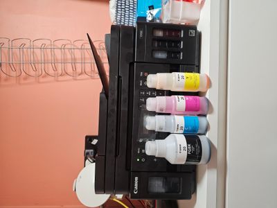

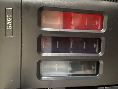

I am new to these type of printers where you pour in the ink. However, the Cayn and Yellow are not full like the Magenta and Black. Is this common?

When I bought my G7020 and filled the tanks I noticed that the tanks filled then shortly went to about half full or something like that after printing. I believe the problem is that the ink tubes and print head need to fill with ink (that's the only thing I can figure). It never happened again, that is, whenever I've filled the tanks, they stayed filled, so I think my surmise is correct.  I'm at 18,000+ pages, by the way.
