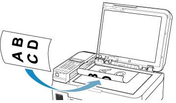

When placing the original face down on the scan glass, please make sure that it is placed near the upper left corner, next to the arrow. The printer cannot scan the striped area (A) (0.04 inch (1 mm) from the edges of the platen glass) as shown in the 2nd image below.

Wow! I am a dork. I’m not at home but will check it out when I return. My scanner is placed too high for me to have seen the guides and I’ve never had a scanner that didn’t use the full glass. It’s weird because I didn’t notice the problem until recently so I thought it was a new issue. That’s why it hadn’t occurred to me that it was user error. Now I wonder how many flawed copies I’ve made. LOL Thank you so much for your help and especially for providing resources with your answer. I appreciate the extra effort. You are a gem.
