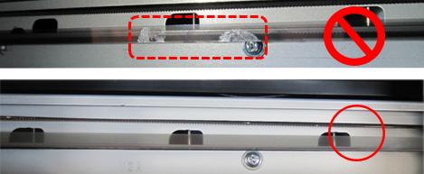

Based on your description of the issue, the Encoder Film inside the printer may be smeared. Please follow the procedures below to check the film condition, and clean it when necessary:
1. Press the power button to turn your PIXMA MG5520 off.
2. Unplug the power cord from the printer. Be sure to turn off the printer power and unplug the power cord first.
3. Open the Paper Output Cover.
4. Check if the Encoder Film inside the printer is clear. The Encoder Film is the transparent thin film. Please view the image at the bottom of this post for further detail.
5. If the Encoder Film is smeared as shown in the image, it needs to be cleaned.

The image that you provided shows the front of your MG5520 with the output tray in the open position.  The encoder/timing strip I referred to above is inside of your printer, behind the ink carriage.
Please use the link below to view the steps to clean the encoder of your MG5520.  There are more images availble in that article which will help you locate this part inside of your printer:
Cleaning the encoder (timing) strip - MG5520 / MG5522 / MG6420 / MG7120
