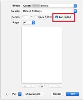

The PIXMA TS8320 is capable of printing on both sides. This feature is enabled in the Print dialog box:
If the application that you are using does not have this option, the application may not support Two-sided printing.
