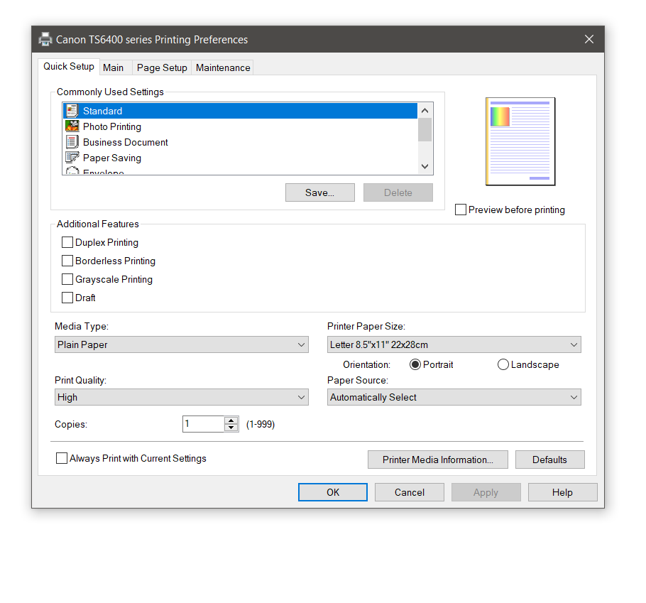

BTW I also changed my settings to High, here are screenshots.

I resolved the issue and the steps above show how I did it. The nozzles were not the issue. It was a windows software compatibility problem.

did you see what I posted for a fix? Windows photos was the problem. I opened the picture with one photo viewer (an alternative app to view photos) and then right clicked to print and the lines are gone. Go back to printing using windows photos and it is back. I also changed the quality and posted pictures to show what the settings where. No amount of cleaning is going to help it is a software issue from what I can tell.
