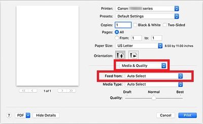

If you are using letter sized plain paper, you can print from cassette. Please follow these steps:
1. In the program that you are printing from, please click on File and then Print.
2. In the Print window, click on "Show details" at the bottom. If you see "Hide details", go to the next step.
3. In the drop down box in the middle, choose Media & Quality.
4. From the Feed From drop down, choose Main tray.
5. Click Print.
