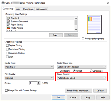

08-18-2026 04:06 PM - edited 08-18-2026 04:11 PM
Hi bhamdodger,
Please try these steps:
1. On your computer, please press the Windows key on your keyboard and the letter I, then let both go.
2. Click on Bluetooth & devices on the left side.
3. On the right side, click on Printers & scanners.
4. Click on the Canon TR8600 series.
5. Click on Printing Preferences.
6. In the Quick Setup tab, look towards the lower right. Click the Paper Source drop down and select Cassette.
7. Click on Apply and then OK.
More informaiton can be viewed in the manual here:
TR8600 series > Printing from Computer > Printing from Application Software > Basic Printing Setup
