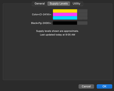

So, I think I may have fixed one issue, I believe it is no longer the AirPrint version, but now when I do press print, it processes, but no ink appears on the printed pages. I'll attach the updated picture of the printer in Printers & Scanners, as well as the ink levels now indicated.
Is there any reason why the printed pages would be blank, while the standard print tests show up with B/W and Color normally?
Sorry, new update.
So, I managed to get it to print, somewhat. Despite what the ink levels indicate, and my re-inserting/checking the ink cartridges, black ink barely registers - when I used red and dark blue text on Word to print, they seemed to show up. I'm wondering if there are any specific ink cartridges to be used for this specific printer, the Canon Pixma 3500, or if it's possible the ones provided with this printer are outdated/old/faulty in some way? Again, color seems to register fairly well, but black hardly at all, despite what the printer Supply Levels show. The seller didn't indicate any of this to me personally, and vouched both inks were supplied/the printer was functioning normally, so just want to make sure it's an ink issue as opposed to a printing/printer issue.

The ink levels are approximate. For my Pro-100 there isn't a direct measure. I am guessing the process is that when a new cartridge is installed the printer assumes it is full and resets the level. Then, as pages are printed the printer estimates usage.
It looks like your black cartridge is not printing when you run a nozzle check. You could try some cleaning attempts and maybe get a new black cartridge.
