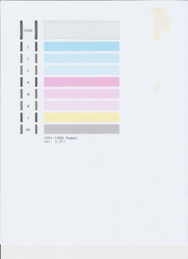

Replaced the Canon brand PGBK with Canon brand cartridge and it refusing to align. Have not tried other colors to see if the whole grouping was bad….and of course I threw away the original box!

Does an error code appear when you try to align? Were you able to print a nozzle check?

Yes to nozzle check and no there were no error codes. It’s as though the new cartridge had a completely different registration for alignment….looking at the printout it seems like I was having double vision…I could scan the nozzle check and attach if you’d like….
If I put the mostly dead cartridge back in, it’s aligned. I wonder if the cartridge is just bad? All have been Canon brand cartridges….

Based on the nozzle check, I recommend a encoder cleaning. Please click HERE for more information about how to perform a encoder cleaning.
