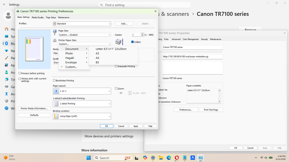

im having trouble on how to print a long document 8.5"x14" on my tr7120. there's no option in the printer paper size for legal 8.5"x14". there's no rear paper tray either, the front paper tray dont have the space for a legal size paper. checked every option on my printers preferences but nothing. i bought this printer for its ADF to scan long documents and didnt tried to print a long documents thinking it comes standard on every printer to be able to print long paper. its been 3 months passed already and this is my first time printing long ones.

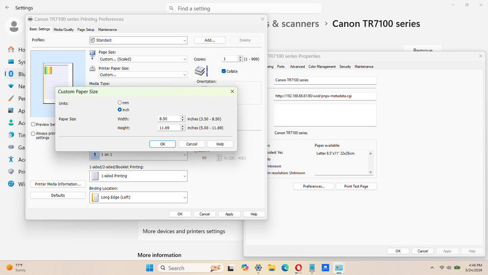

i tried that one but theres no option to enter the size of the legal paper, and the front tray paper does not have space for 8.5x14. i can custom size the page size to 8.5x14 but for the printer paper size it only max to 8.5x11.

Hi Derrick,
It appears we have conflicting info between website specs and the tech sheet. I'll reach out to our web team to confirm which is correct!
thank you so much. and if ever there's no option for legal size docs, whats the best solution for me, i just also bought a new set of ink cartridges.
I apologize for the misinformation in my post. Apparently Canon had two specifications pages for your printer and one apparently has incorrect paper handling sizes. This one should be correct.
https://www.usa.canon.com/shop/p/pixma-tr7120
from the above support site:
Supported Paper Sizes
4” x 6”, 5” x 5” (Square), 5” x 7”, 7” x 10”, 8” x 10”, Letter (8.5” x 11”), U.S. #10 Envelopes, Card Size (91mm x 55mm)

What's the best thing for me to do now that my printer cannot print on 8.5x14? It's almost 3 months old now. Thank you for your reply.
Hi again,
We'd recommend checking the return policy with the merchant you purchased it from to see if a return or exchange is possible!
Hope this helps!
Will do that. Thank you so much.
