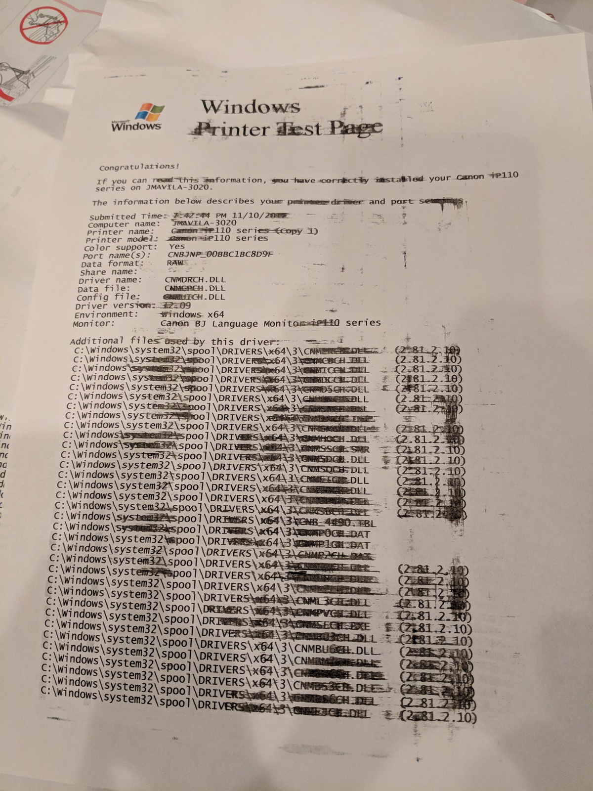

Cant understand why it keeps smudging. Just using plain paper, just printing the test page. Very frustrating.
Tried:
Cleaning
Deep cleaning
Print head alignment
Nozzle check
Bottom plate cleaning
Roller cleaning
Increasing dry time to max
01-16-2018 04:56 PM
Hi nappyjim,
If ink is still smudging on your prints, let's reset the paper thickness lever. Full instructions can be found starting on page 451 of the manual HERE.
This didn't answer your question or issue? Please call or email us at one of the methods on the Contact Us page for further assistance.
