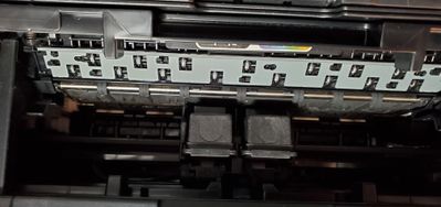

Hi Patrick. I just went to the link you provided. But I don't see where my encoder film is. Sorry for some reason this keeps uploading upside down I apologize.
01-07-2022 02:56 PM
Hi,
The encoder strip is behind the ink cartridges. You can unplug the power cord to the printer and gently move the inks out of the way. You may need a flashlight since the encoder strip can blend in.
