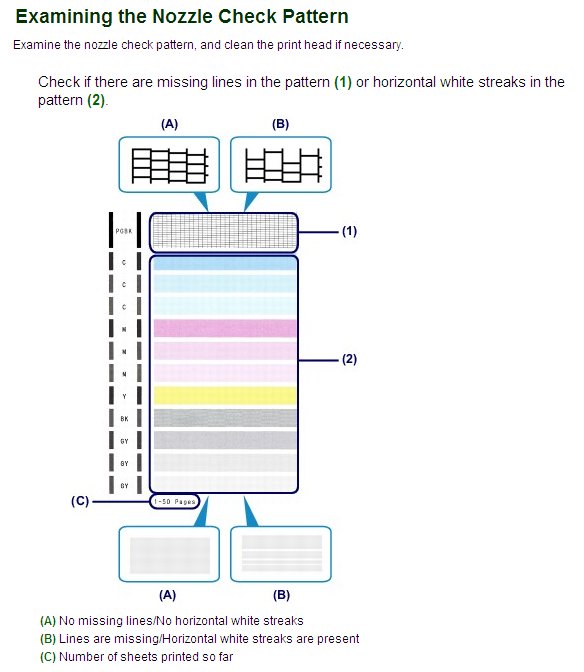

Two-year-old Pixma MG 6320 has stopped printing text.
Won't print text from either wifi connected computer.
Won't print text on Windows-generated printer test page, but will print Windows color logo at the top of the test page.
Printer print head test page has full color on all panels, including black and grey, but won't print the grid.
Prints images fine, including black sections of images.
If I create a pdf of a document it won't print the text of, it will print the pdf image just fine.
This same thing happened to my previous Canon 6320, but as it was a hand-me-down, I replaced it with a new one.

Next, a test of the printer should be performed. This will tell us if the printer is working correctly. To do this, please load letter-sized paper in the PIXMA MG6320 and follow these steps:
1. Flick the HOME screen and then tap Setup.
2. Tap Maintenance.
3. Tap Print nozzle check pattern.
4. Tap Yes.
The Nozzle Check will print. Please compare your printout to the example that has been attached to the bottom of this post. If they differ, please perform a few printhead cleanings.
To perform cleanings, please follow these steps:
2. Tap Maintenance.
3. Tap Cleaning.
4. Tap Yes to clean the printhead
5. Tap Yes to print another Nozzle Check.
Does the Nozzle Check print correctly?
If not, please contact our support group using the following link:
