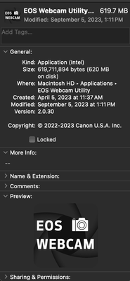

Hello,
I have the same issues. I have a Canon EOS Rebel T7. I'm on a 2019 Macbook Pro 16-inch running Sonoma 14.1.1. I use Canon as a webcam with EOS Webcam Utility via Zoom, BigBlueButton, and daily.co for education. Previous to OS 14.1.1 ( so 14.1.x) everything was working just fine and I'd been using the camera as a webcam for a few years.
After the update, If I use the EOS Webcam Utility Pro version I can see the camera working perfectly via the scene preview. However, when I try to run the camera via any one of the apps i mentioned the camera doesn't even list in the options. I'll see either the default built-in Mac camera or a backup C920 Logi camera.

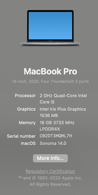

One other important point is I have a secondary intel Mac for my work as a dev it is on OS 14.0 and the camera still works.
When I inspect the version or info of my EOSWU I have the following:
Note the above screenshots are from my work machine however my personal machine which is not eve seeing the camera has the same EOSWU version of 2.0.30.
