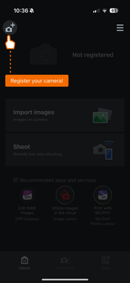

I noticed that the USBC connection option isn’t showing when registering the R3 with the Canon Camera Connect app on iPhone…. Is this an app error?

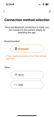

this is what I see with my iPhone 16 pro
I am able to connect via usbc and import photos to the photo library, but I’d like a hardline connection for auto-transfer and live view shooting video purposes. im able to get live view via usbc with 3rd party apps, but missing touch to focus while recording video. The canon app can do this via WiFi connection, but it’s really unreliable and actually worked better with the iPhone 15

the app does not give a USB option for R3, R6, and R5 regardless of what the usbc setting is in camera...
That's the whole point of my post.

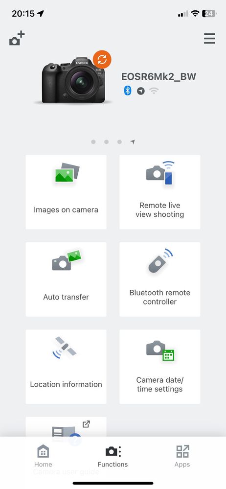

Here's my iPhone, with an EOS R6 Mk2 that has the same menu setting as your EOS R3. I have previously used the camera connect app with my camera over WiFi.
In the first screen the camera is switched on but the cable is not connected, the bluetooth is active on the camera and it's paired with my phone, you can also see location is active, but not WiFi.

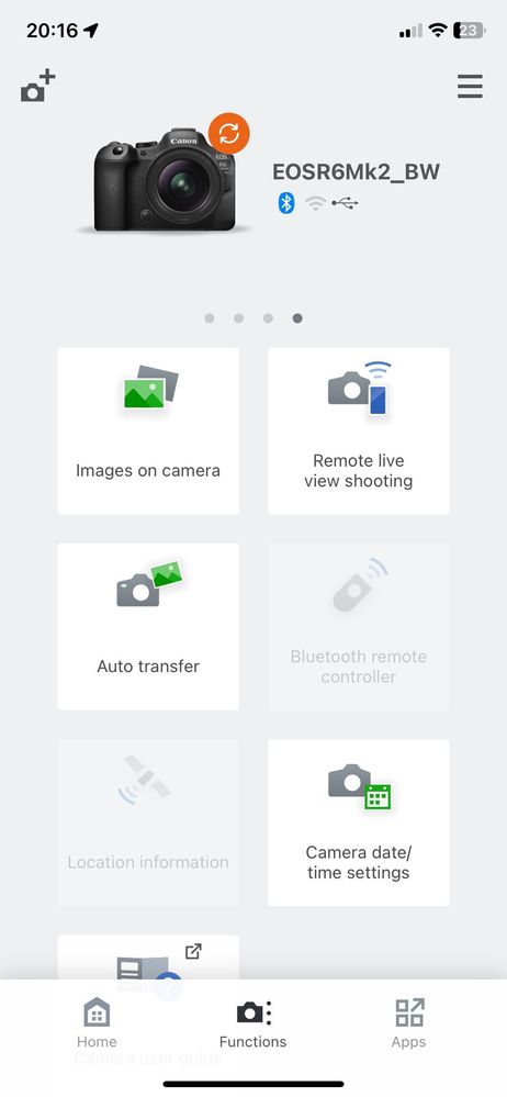

Now I plugged in the USB cable and the display changes to show that the USB connection is connected.

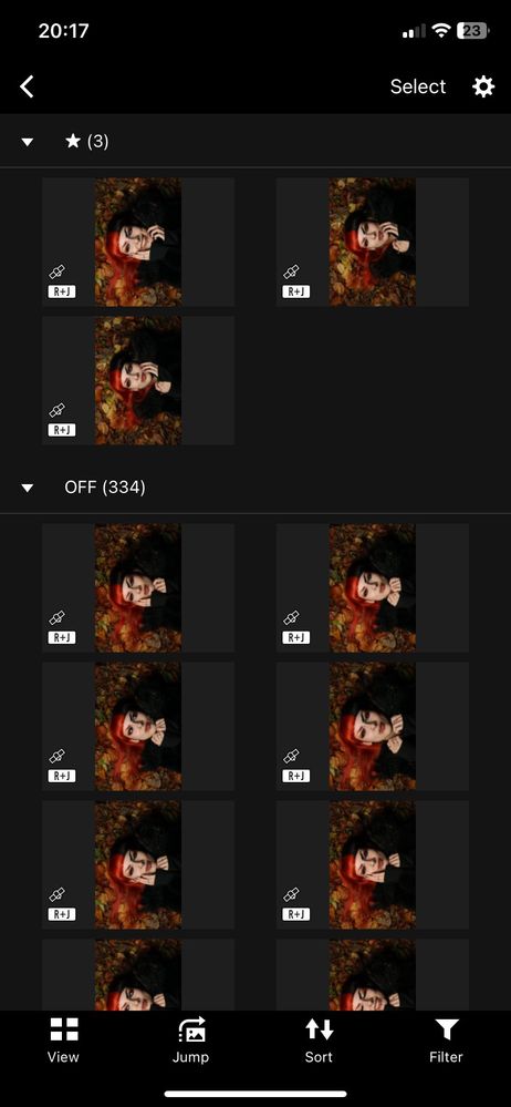

I then selected Images on camera to preview the shots on the card and very quickly did the images show up. Much faster than is possible with WiFi.
