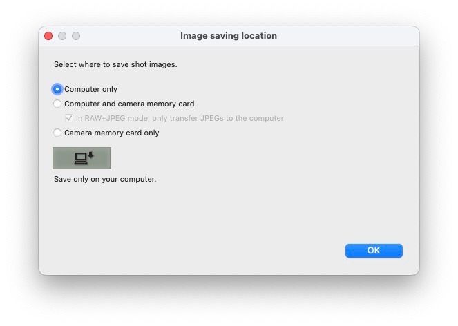

EOS Utility gives you a choice of where the files are stored, there are three possibilities:-
With the third option, you can choose that when shooting RAW + JPG that only the JPG is transferred. I use this very often for portrait shoots. I set RAW + SML JPG on the camera, so that only the small JPG is sent and this is more than large enough to fill the screen on my computer and see detail.
If you choose option 2, then the camera file number is not known, since it would depend on the image being stored on a card and follow the camera's file numbering.
Here's EOS Utility screen captures, to the right of the RAW + S1 JPG is the save location. Click on it and it shows the options in the second screen.
