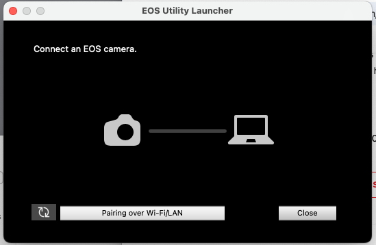

I then connected my R6 to mac mini 2 via usb, and all that I can see on the R6 screen is a silhouette of a pc monitor & keyboard, plus a "full battery" The Eos utility launcher shows a box with a camera and connection line to a pc, and underneath that another box states "Pairing over Wi-Fi/Lan" but so far my R6 isn't seen on the Eos 3.
I did launch the "Image Capture' via applications, and yes, it shows my R6 MK2 under devices with my canon printer.
I'm not sure how to proceed now. Image capture can see my R6, Eos 3 is "pairing" over Wi-Fi/Lan, see screen shot,  but no success, I have an SD card via usb to copy the V3 update to, and I have the V3 update sat on my desktop as a dmg file. I have been able to open the V3 update, but when I attempt to copy it to the SD card, a message reads the it is already on the SD card, but when I check the card it is empty.
Any help / ideas always appreciated. Many ThanksScreenshot 2025-01-04 at 14.07.26.png

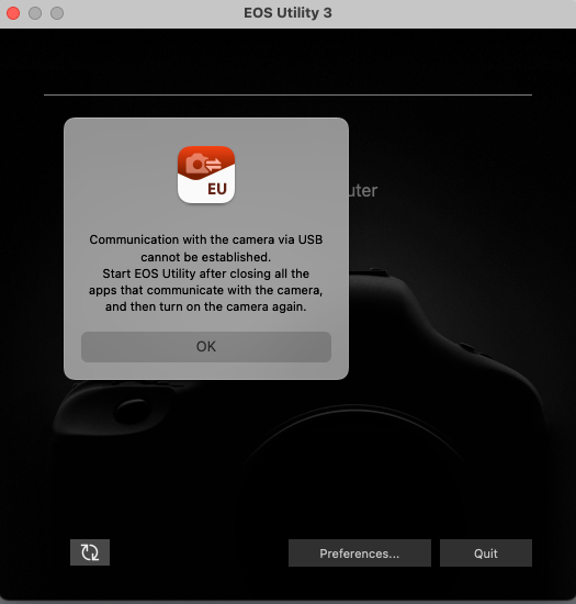

Hi and many thanks. I did as you suggested and got the two below screen shots. I have closed all apps and attempted to connect the R6 but no success. The "Blue" dialogue will apply after the R6 is connected.Screenshot 2025-01-04 at 14.40.36.pngScreenshot 2025-01-04 at 14.41.00.png
Are you using EOSU version 3.18.5? Do you have any background applications running that would download images (like Dropbox?). You said you used Image Capture. Did you terminate operation? I tried on my MacBook and if IC was running EOSU3 wouldn't connect (but I didn't get the notice you did.).
