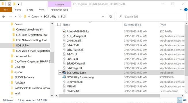

Try running the utility from the file EOS Utility 3.exe. See if that makes a difference.
That vintage cameras may need to run EOSU2.
