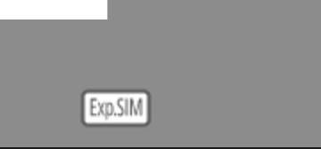

I do see this icon, but grayed out... sort of:
Screen Shot 2022-07-10 at 1.15.45 PM.pngScreen Shot 2022-07-10 at 1.15.45 PM.png
Ok, I did find that in the 80D Menu, disabled it, but had no effect on the issue.  I've also tried two other tethering apps, and they both behave the same:  won't send a signal to the hot-shoe in live view mode.
