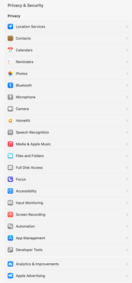

Greetings,
On an aside... Please look in Security and Preference and check permissions for the EOS Utility. I have a untested theory that permissions might be what's keeping external devices from connecting. I would still uninstall, restart and reinstall first. I have not tested this yet with Ventura.

03-09-2023 05:10 AM
I have no such "security" option after: System Settings > Security and Privacy
I have Mac Studio M1, running Ventura 13.1. I had previously attached and streamed using my 5D Mark IV for streaming to my Macbook Pro. I just updated the cameras firmware and no luck. Yesterday, the camera connects to the EOS utility but would not connect on Streamyard. Now today, the computer is not recognizing it at all.
07-21-2023 02:36 PM
So for my 5d MarkIV running Ventura 13.4.1 adding EOS Utility to open on login connecting the camera and turning it on. Then log out and log back in this worked for me. Good luck
