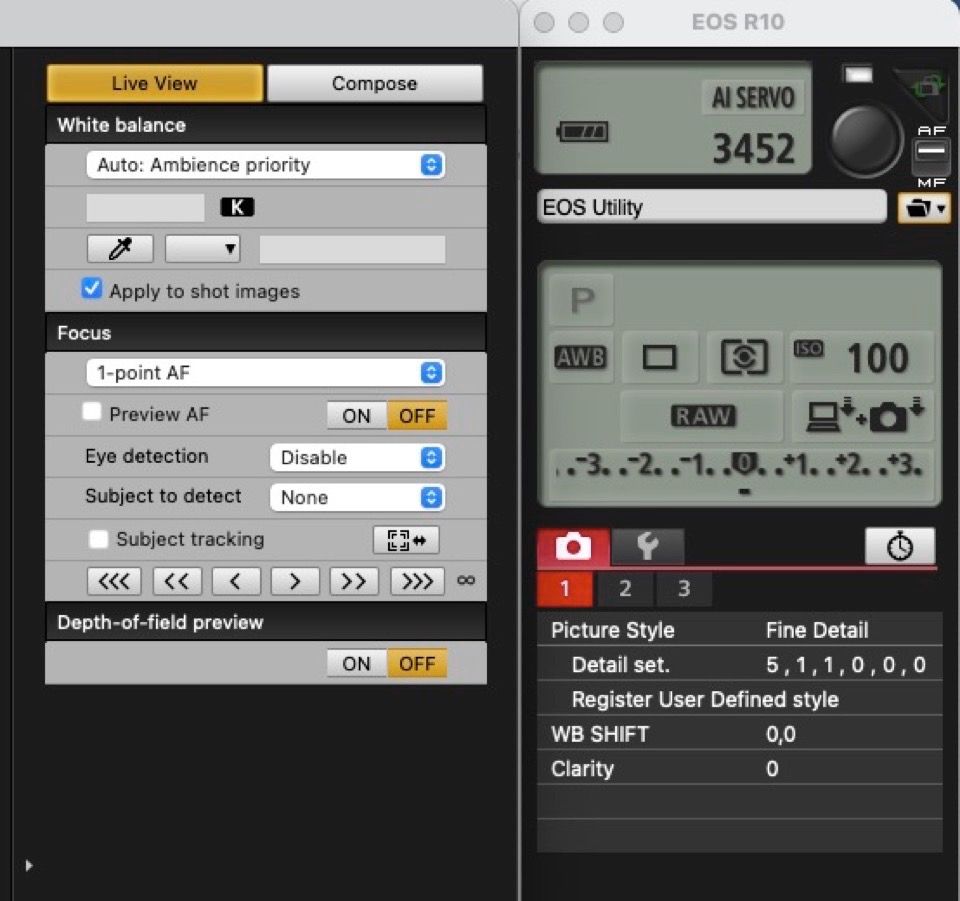

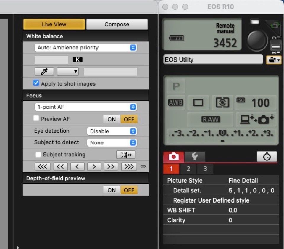

In EOS Utility there you can select manual focus from the main window, but this does not allow the focus buttons to be used, you have to also remove the check mark from Preview AF.
In the screenshots below you can see the AF/MF remote switch has been set to MF, but with Preview AF still active the focus buttons are not active.

However when Preview Af is disabled you can then operate the focus buttons.

Lastly I found that you can leave the camera in AF, and with Preview AF disabled then the focus buttons are active, however you might find the camera refocuses when the shutter is pressed.
