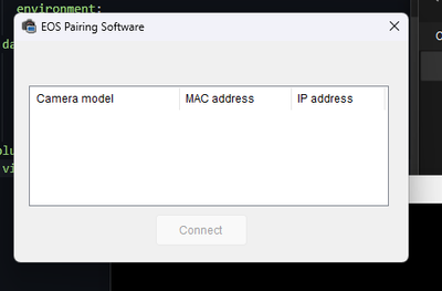

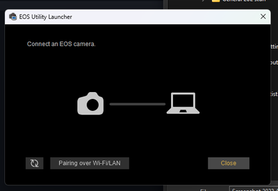

I tried using the Pairing over Wi-Fi/LAN shown below:
but the pairing window does not show any devices available on the network.
Since the plugged-in mode of the application worked, I wanted to try getting the two devices paired while connected over USB, but it is not possible to select the WiFi pairing mode while the camera is plugged in. Instead what happens is the app loads a menu. The download images slot is greyed out, probably because I have no SD card in the camera.

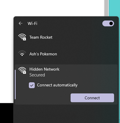

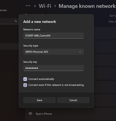

As for the direct WiFi connection, when the camera creates its own network, my computer sees a Hidden Network, which I believe could be it, but it will not connect if I type in the password given by the camera.

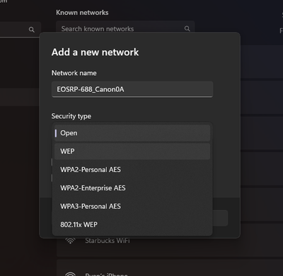

My computer will also not connect if I define a new network using the given SSID and password and check the box that tells it to connect even if the network is not visible.

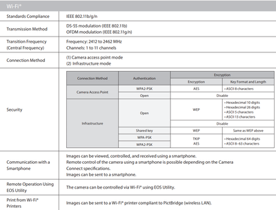

It is unclear whether I should be using WPA3 or WPA2 or WEP. This detail is not mentioned in the official Canon documentation.

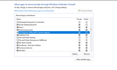

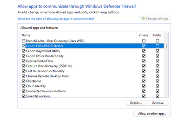

I answered most of those questions in the new post. As for the firewall, I believe the installer/EOS utility asked for permission to communicate through the firewall, which I granted.
The firewall allows it through only on Private networks. My ethernet network is specified as Private, so this should not be a problem.

For security I'd use WPA/WPA2 AES

Update. Confirmed camera only supports 2.4Ghz WPA/WPA2 AES
