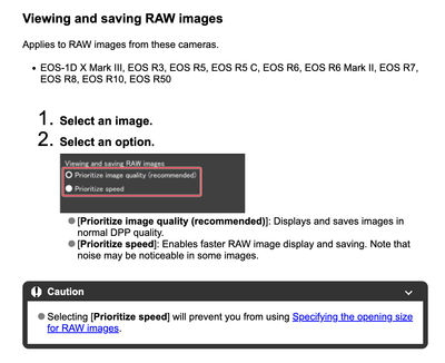

One setting that might do that: https://cam.start.canon/en/S002/manual/html/UG-04_EditImage_0040.html
11-09-2023 10:08 AM
Can you provide your computer specs please? The rendering literally takes a second or two normally.
