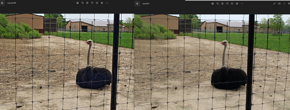

In your case (one properly exposed file), DPP is simply adding it's presets with some adjustability (that are intended for a bracketed composite) to your properly exposed image. Although I knew what the results would be, I ran one of my underexposed bracketed files and used all of the "Art" presets and played with the sliders as you requested (see attached). I'm not impressed. Note that the key word in all but the Natural preset is "Art" (I used Natural in my previous composite). These, as the name implies, are for artistic renderings of what would be a normally exposed image. If art is what you are after instead of a natural looking scene, by all means have at it. But you can not expect accurate EXIF data from an artistic rendering of an image. If anything, maybe the preset used and its slider values, but certainly not the exposure triangle as that is long gone when you add the Art presets to manipulate your image.
With Art Standard +Brightness applied.
Art Standard Using Underexposed Image
