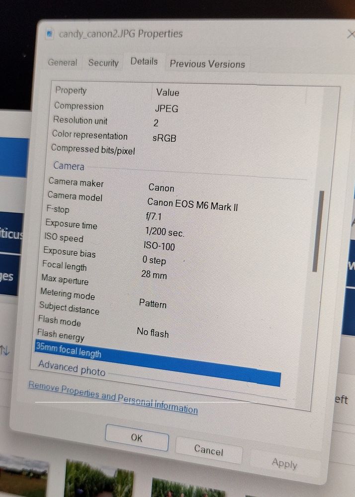

Exiftool needs two parameters in addition to TagsFromFile when the destination image has had the makernotes section stripped out. Exiftool also needs "-make -model".
exiftool -TagsFromFile IMG_6759.CR3 -makernotes -make -model DC_IMG_6759-6764.JPG
10-16-2023 05:38 PM
That's funny I don't appear to be missing anything. I was just following the internet instructions. The image below is from my command.IMG_20231016_173226607_HDR.jpg

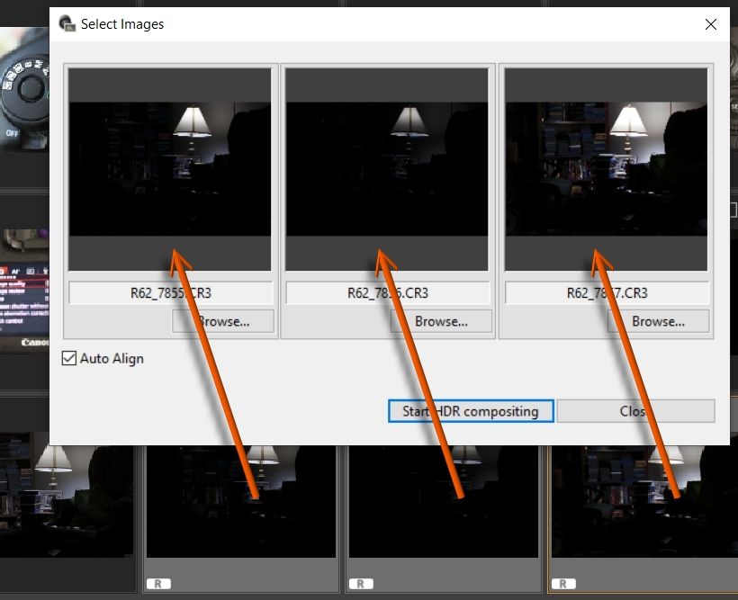

So that means you are not making HDR, or more precisely "Exposure Bracketed" files. The process must start in camera using the HDR or Auto Exposure Bracketing (AEB) feature in your R6 mark II. I'm not sure what shenanigans DPP is up to by allowing only one file to be processed, but that's just not the way it's traditionally done (see Attached). I suspect that it is just applying the effects that it would normally do for an exposure bracketed file.
You start by taking three images: Normal exposure; Under exposure; Over exposure by setting + and - exposure in addition to your initial correct exposure either in the R6II's HDR or AEB feature (please look in the manual for these procedures). The difference being that the HDR feature will create an in camera HDR with an option to save your original files and the AEB feature will just make your three files to be processed in DPP (or whatever program you wish to use). Tip: Set your R6II drive to continuous and it will quickly shoot your three exposures, if not, you will have to press the shutter three times. Also, you can do this "hand held" because the R6II does this very quickly (Elec. Shutter) and you can enable "Moving subject". You then process these files to create a file with a higher dynamic range. Not necessarily a better color gamut, but more detail in the dark, light, and mid-tones, the sum being better than the parts.

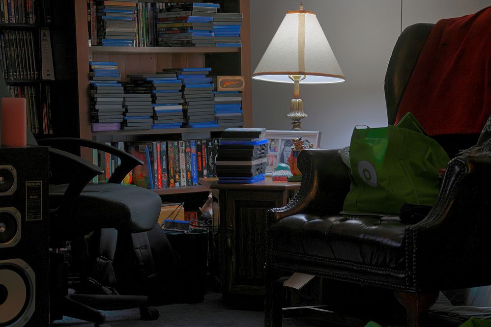

These are three down n dirty shots I just took with the R6 mark II and processed in DPP 4. The second attachment is the bracketed HDR of the three CR3 files.
Three shot HDR/Exposure Bracketing
Traditionally (the correct way it's done), exposure can be changed in several different ways and I've noticed that sometimes a combination, like one file may have a different ISO and the next shot in the series will have a different shutter speed and ISO. Also traditionally, and I've been exposure bracketing quite a while, long before DPP included it as an option, EXIF data has never been included. The final composite can not be represented properly by any of the original EXIF data. You can paste data all you want, but it won't even be close to what the final image represents and I seriously doubt Canon is going to do anything about this because, as mentioned, the EXIF data in the composite will not properly represent any of the three images used for the bracket.

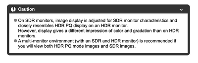

https://cam.start.canon/en/S002/manual/html/UG-12_HDRPQ_0010.html has the DPP manual section on HDR PQ.
There is also a list in the manual of all the normal things that are not available in HDR PQ mode in DPP.

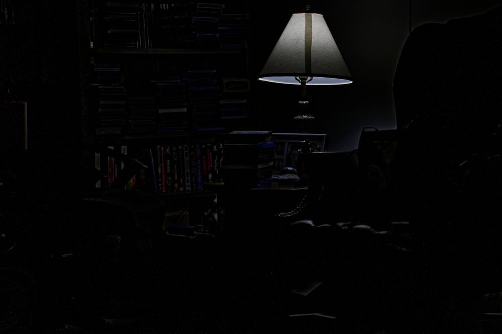

In your case (one properly exposed file), DPP is simply adding it's presets with some adjustability (that are intended for a bracketed composite) to your properly exposed image. Although I knew what the results would be, I ran one of my underexposed bracketed files and used all of the "Art" presets and played with the sliders as you requested (see attached). I'm not impressed. Note that the key word in all but the Natural preset is "Art" (I used Natural in my previous composite). These, as the name implies, are for artistic renderings of what would be a normally exposed image. If art is what you are after instead of a natural looking scene, by all means have at it. But you can not expect accurate EXIF data from an artistic rendering of an image. If anything, maybe the preset used and its slider values, but certainly not the exposure triangle as that is long gone when you add the Art presets to manipulate your image.
With Art Standard +Brightness applied.
Art Standard Using Underexposed Image
