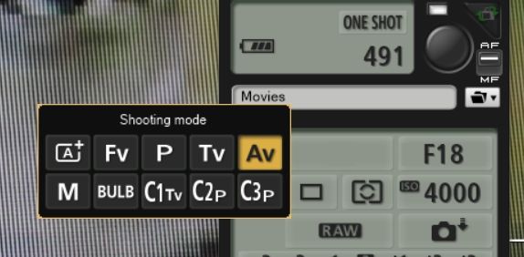

I understand that you are wanting a preset, but honestly you wouldn't be saving that much time. With just a few mouse clicks or taps, you can switch those settings in a matter of seconds in the EOSU. I do it quite a bit with my cameras.
What you want is available in the EOSU, but just for cameras that do not have a mode dial, like the R5 (see attached). As you probably know, shooting mode will be grayed out for cameras with a mode dial 😞
