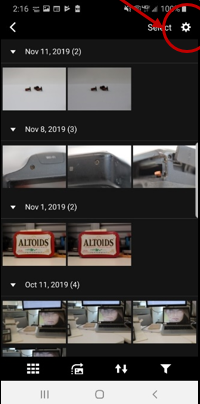

Hello!
We're so sorry for the extended delay while we worked on getting this right!
Here's how to keep the location information when exporting images via Wi-Fi:
1) Start the Canon Connect App and establish a Wi-Fi connection with your camera.
2) Select "Image on Camera"
3) Select "Setting"
4) Select "Delete Location Information"
5) Default setting should be "Delete"
6) Select "Don't Delete" and click "Ok"
We hope this helps! If you have any questions our support team is happy to go through this step by step. They can be reached at 1-800-OK-CANON (1-800-652-2666) Monday-Friday 9:00 am to 9:00 pm ET, excluding holidays.
Yes, that works. Thank you.
