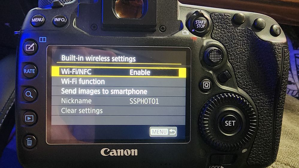

03-09-2023 08:54 PM
I could not clear settings as it was blacked out and could not choose it. I did change the nickname but it still a no go.

Greetings,
Based on what I'm seeing above the user had a nickname on his camera (SSPHOTO1) set, and a saved profile (SHANECAM-219_CanonOA) saved on his Canon Connect App which do not match. My recommendation would be to reset network settings on the camera and forget the saved profile on in the CC App and perform repairing.
