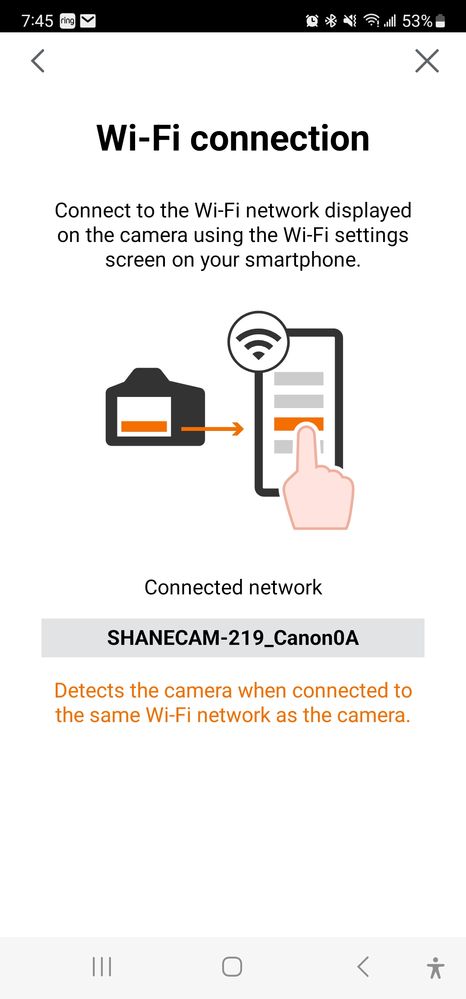

The app updated and now I can not connect to my camera. I get as far as connecting to the camera's Wi-Fi but it will not go past that point. Can I roll back to a previous version of camera connect?

I could not clear settings as it was blacked out and could not choose it. I did change the nickname but it still a no go.

Based on what I'm seeing above the user had a nickname on his camera (SSPHOTO1) set, and a saved profile (SHANECAM-219_CanonOA) saved on his Canon Connect App which do not match. My recommendation would be to reset network settings on the camera and forget the saved profile on in the CC App and perform repairing.
If you are having the "same" problem it's likely related to the different names. I suspect however, your issue is unrelated. Because this thread is approx a year old, I suggest that you start a new thread with information about your particular situation, hardware, mobile device type, OS, etc. This ensures your issue get the visibility it deserves. Thanks in advance.
