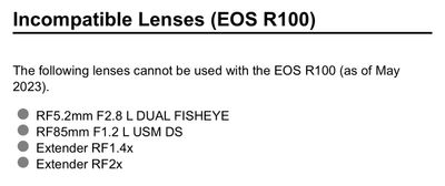

I'm just a little confused. I have a beginner Canon EOS R100 and have purchased a new lens 100-400 and works fine. I first started with a used 75-300 EF mount with an adapter, then purchased used EF teleconverter so I got 150-600. I wanted to change everything to all RF mount lenses so I purchased the RF mount 100-400 lens. I was a little upset that the extender 2.0 was so expensive (more than the 100-400 lens that I purchased). I made sure the 100-400 lens was compatible with the rf 2x extender but now I've read somewhere the extender is not compatible with my camera EOS R100. It fits fine on my camera but I just want to make sure I'm not messing the camera up. I do want to eventually purchase a nicer camera (EOS R7). This bird watching hobby I started is quite expensive. Is it ok to use the extender on my camera without messing it up? I don't understand how it could not be compatible if it goes right on my camera no problem

Teleconverters are NOT COMPATIBLE with the EOS R100. The problem is the older hardware in the camera body. Not the camera’s physical lens mount. Or the lens being used. I would avoid using teleconverters on your camera. Even though it may mount it’s not a compatible combination. It may or may not cause damage to your camera.

From Canon's website on the RF 2X extender compatibility page:

I was going to give you the same information that Demetrius did.
You can read this in a Canon website called Supplementary Information for the R100
https://cam.start.canon/en/H001/supplement_0170.html
