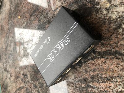

I already have this hub, so I can add additional TVs / Monitors as and when required.
