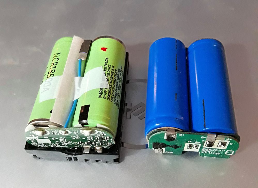

Sorry for the late reply... Been busy 🙂 I've done a few battery tear-downs over the years and the last ones that I did were on a Canon LP-E6N, LP-E6NH, and Wasaby LP-E6. All were basically the 18650 cell design - "jelly-roll" - but are the shorter 18500 form, same diameter, just shorter length to fit Canons battery pack design.
Now, Canon is pretty hush hush on the details and Panasonic, who makes the cells for Canon, isn't giving up any info so we are left with getting reports from folks who are doing tear downs and/or using other technologies, like CT scans. This really doesn't shed any light on the formulas used, like lithium and other critical materials. It's my understanding that they increased the amount of "critical" materials (stuff that makes the juice) in the higher end LP-E6NH and LP-E6P.
On the left is a Canon LP-E6N but the H, to my eye, is the same. On the right is a Wasabi LP-E6.
Canon LP-E6N (R) and Wasabi LP-E6 (L)Canon LP-E6N (R) and Wasabi LP-E6 (L)Canon LP-E6N ElectranicsCanon LP-E6N Electranics

Some edits to my post: *Panasonic makes newer cells for Canon, but the battery packs are assembled in China.*
*In my first image, the Canon battery pack is on the left.*
