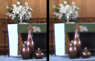

Here's an example of how blurry it gets.
The left image is a snippet from the video near the start, and the right one was taken near the end:

There's a couple things that could be going on here. The first could be if the focus is accidentally changed while filming. This is not the most likely since the R800 doesn't use a focus ring but it is still possible. Otherwise this could be caused by heat buildup, either by causing condensation in the lens if you are in a humid environment or by the sensor becoming warm over time. If possible I would recommend testing the camera for about 45 minutes in a diferent environment to see if the issue carries over elsewhere.

Focus can't be accidently changed during filming, it's on a tripod where nobody can touch it and I let it record for about an hour without touching it.
The camera does get quite hot while filming... Is there a way to cool it down a little? Would it help to uplug it and let it film only from the battery?
