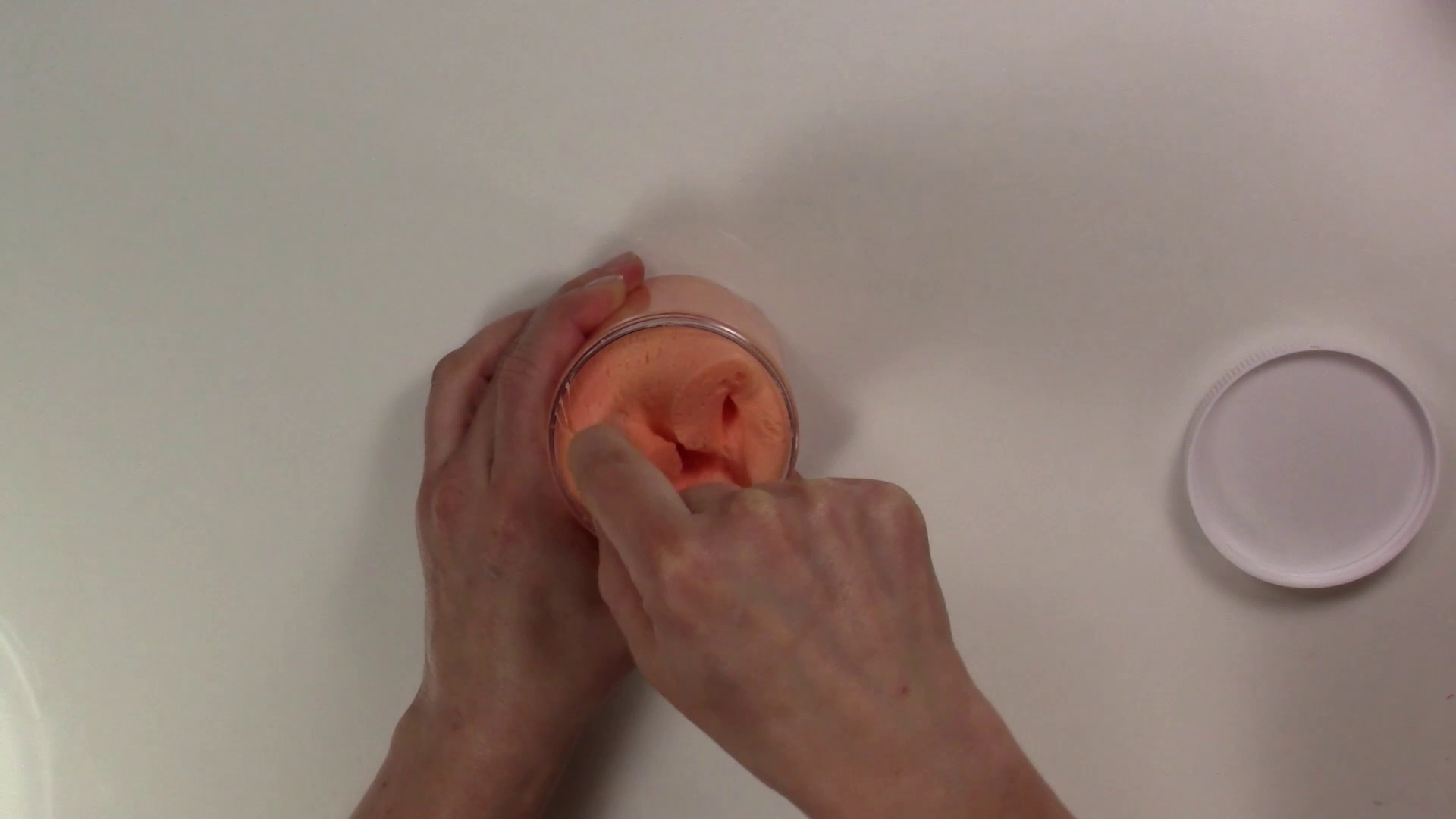

Just so you have some idea what's going on here....   the first image here is what plays on the recording off the MP4 files.  The second image is color corrected with my video editing software, and is a fairly close representation to what is shown on the screen of the camcorder and on the TV.

The photo shows insufficient lighting.

The format matters because movies shot in the AVCHD format tend to be more fragile than those shot in MP4.  Dragging them off can permanently damage them.  Based on the images you've supplied (thanks), that doesn't appear to be the case here.
From your images, it looks like a different white balance setting should resolve this issue.  The Auto White Balance (AWB) setting is good for many scenes, but sometimes, a manually selected white balance setting works better.  This appears to be such case.
You may manually select the white balance setting when your camera is set to its "P", "Cinema" or "Highlight Priority" modes.  To access this setting, choose "Home" icon, then "Main Functions" (camcorder with gear icon), then choose "White Balance" then choose the white balance based on the light source for the scene you're shooting, the "X" out of the menu.
