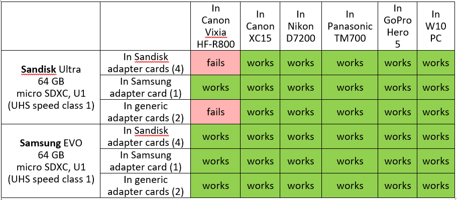

UPDATE.
Turns out the SD card adpaters are definitely part of it, but it's complicated ...
I rounded up seven different micro SD card adpaters, and tested different combinations (card + adapter) in different devices.
The HF-R800 and Sandisk are the sole fussy combination. They only work together when I use a Samsung adapter.
Every other combination works: (1) the Samsung card* works in the HF-R800 no matter the adpater, and (2) the Sandisk card* works in my other four cameras and my PC, regardless of the adapter.
* both Samsung and Sandisk micro SD cards are 64 GB class 10 UHS-1.
So it's not completely an adapter thing. And evidence says it's not a UHS-1 thing (see my related reply below this one on UHS-1).
Maybe the HF-R800 SD port flexes the cards a teeny bit, breaking electrical continuity at the contact points in most of my adapters, but which the Samsung adapter fends off better somehow (maybe it's stiffer or perhaps a crucial mil or two thinner)? Just a guess. No circuits in these adapters that I know of. Just a conduction path.
