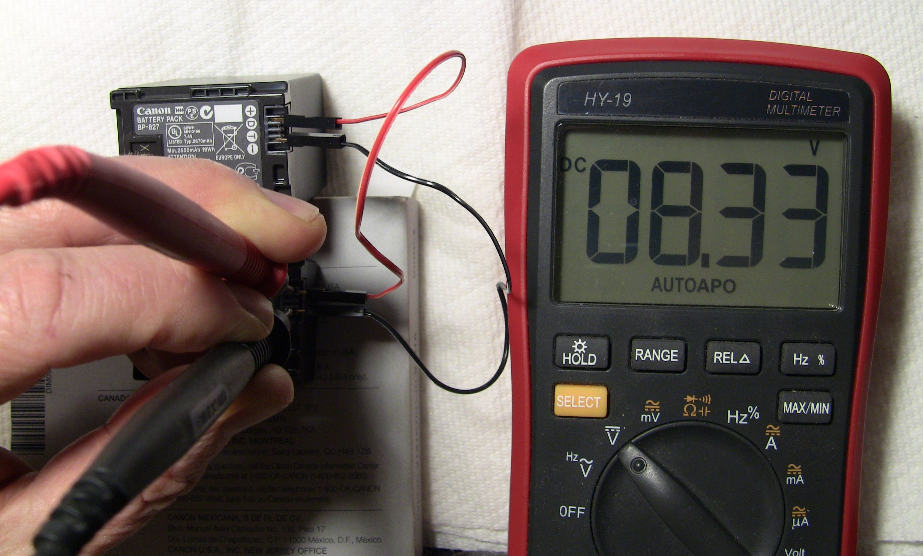

Hello, Is there any way to revive or jump start a lithium battery that sat for years in the package? Got a pretty good deal on a sealed new old stock BP-827 battery on Ebay. Original Canon made in Japan. In my HF S10 at first it seemed to be taking a charge then when I went back I believe the light was off but battery would not start camera. Removed, tried again. 7 blinks x2, pause, then rapid blinking which I gather means faulty battery or charger. Tried in Canon external charger, no go. Fortunately the seller takes returns, just checking before I [sadly] send it back.

My HF S10 cameras and canon charger have been charging Canon batteries for years, no problem here on my end. Like I said I purchased a made in Japan new old stock genuine Canon battery on Ebay and it appears to have sat too long, showing zero voltage. I assume Canon no longer has their batteries made in Japan, yes? That would mean the battery is at least as old as whenever you stopped doing that.
I had "jump started" 18650 lithium batteries when they are too low to be seen by a smart charger, that's what I was asking, can you do it with these. I went ahead and tried using a fully charged Canon battery showing 8.34 volts. I went + to +, - to -, don't know what the "D" and "T" mean. Left them connected for almost a half hour with no change, usually you're only supposed to connect briefly, just enough to get the battery voltage above where the smart system will see it.
I guess it's dead then, yes? Unless anyone knows any other revival tricks. thanks
