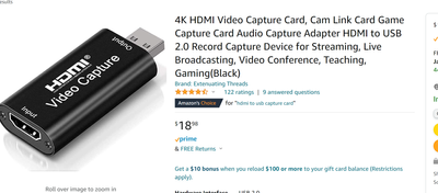

If you don't have many tapes, using a transfer service is probably the best option
If you have a lot of tapes, I recommend a capture device. Also helpful if any of the content is questionable.
Easy solution:

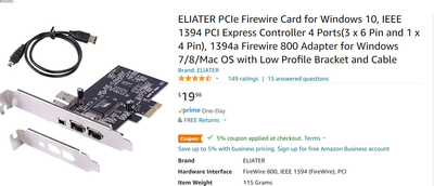

If you have a desktop and want to go old school, something like this. It even has the cable
Last items. If you decide to do the transfers yourself, you'll need some disk space to store the captured footage. Also, both of these will require some sort of capture or editing software. Simple basic capture is 100% free. If you need something that does creative fades, transitions, text overlays or allows you to add audio tracks, etc. it may cost a little.

The simpler solution above involves connecting the camcorder to the capture device via a full-sized HDMI cable. Then, that device plugs in to your computer's USB port.
The card solution would require you to use FireWire cables.

Thanks again. I bought Elgato Video Capture and after trial and error, it's now the method that I use to transfer video from my camera to my computer.
